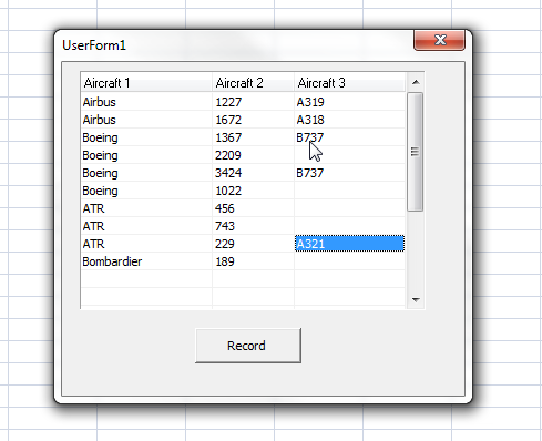

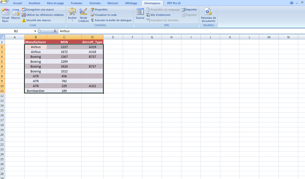

Hi Igor,
Thx for your quick Reply. Here's the idea of my project (See attached pics):
1 - I have a database in an Excel Sheet with 3 columns and 20 rows.
2 - I want to fill the grid with this values (as initial display)
3 - Then, I need the user to be able to change the content of a cell if wrong (the "A321" cell for example is wrong).
4 - Of course, he must also be able to fill an empty cell with data
5 - Then, when he is done, he clicks the "Record" CmdButton and I save the whole grid in the same Excel sheet to update values.
Actually, I'm not sure what function could I use to:
1 - Create the grid (as a 3x20 table)
2 - Display initial values and save the updates after modification in each cell OR at the click on the Record Button.
Thank you for your help on the code for these actions.

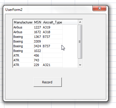

2013-10-31T13:46:32Z
Thx a lot Igor, the code works perfectly! You're awesome! Even the Header set up and the automatic number of row are fine! (See attached).
For the Second part of the project:
Quote:
As for the second part (editing and saving values), I have some questions:
1) Do you need to save the new cell value after the cell has been edited? Then, I guess, we do not need the Record button at all.
Yes, it would be better to remove the Record Button and save the User modifications after each cell update.
Quote:
2) Can we add/remove rows to the original Excel database?
Nope... I'd prefer we don't change the Original Database because it's a very big one (The pic I sent you was just a very small part of it). Why?
Quote:
3) What validation of new input values are you going to use?
It's gonna be "Double", "Text" or "Date" format validation.
Thank's again!

And now, with your code, the user can change the cell value. We just have to save it back in the database.
Here's the attached...
Thx!
RRO attached the following image(s):
Igor/10Tec
2013-11-01T08:16:56Z
Then this is very simple and is done with one call in the BeforeCommitEdit event:
Private Sub iGrid1_BeforeCommitEdit(ByVal lRow As Long, ByVal lCol As Long, eResult As iGrid500_10Tec.EEditResults, ByVal sNewText As String, vNewValue As Variant, ByVal lConvErr As Long, ByVal bCanProceedEditing As Boolean)
   Cells(START_ROW + lRow - 1, START_COL + lCol - 1).Value = vNewValue
End Sub
Note that you even do not need to check whether the input value is in the proper format - iGrid will check that automatically and display the "Invalid value: Type mismatch" message if it cannot convert the entered value into the type of the original cell value (date, number, etc).
This is the default behavior, but you can turn it off and process input errors by yourself. For more info, see the SilentValidation property.
