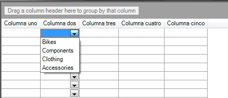

and this is the result:
Click to View Image183 View(s)
Igor/10Tec
2015-07-07T14:23:26Z
The keys of the column you create should correspond to the field names in your data source. Here is the pertinent excerpt from the manual:
Quote:
The FillWithData method provides you with an ability to load not all the columns from the specified data source to the grid. In this case you need to create the required set of columns in the grid first and then invoke the corresponding overloaded version of the method in which the second parameter, useCurColSet, is set to True. The column keys of the existing columns in iGrid will be used as field names in the specified data source. If a column does not have a string key or it does not correspond to any column in the data source, the column will remain empty.
