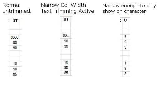

Hi, Im getting some quite nasty behaviour in some cells. Actually its all cells but when the contents are integer values its particularly nasty.
Please see the screen shot:
Click to View Image107 View(s)
This is very misleading, if a user is scanning values in a grid and is reading incorrect values this could lead to some potentially catastrophic outcomes for a business. It renders the grid almost unusable and potentially dangerous to use.
Is there a way to fix this behaviour up, the cellstyle.value types have been set to integer.
Taking excel as an example if a col has shorter width than its contents it will display '#' to inform the user that the content isn't representative of its value, it would never trim a character from a number.
Hope there is an easy fix for this. iGrid 4.6

Hi Igor, thanks for the reply. Yes that is exactly what i mean. Unfortunately non of the iGStringTrimming make a difference when only one character is visible.
Click to View Image105 View(s)
As you can see, the visualisation for trimming works but only where there is room enough to display the ellipsis also. As soon as the col is narrow enough to only show one character the character takes priority and removes the ellipsis. In this situation (the right most on the screenshot) the values appear to be incorrect because there is no indication that the cell content has been trimmed.
