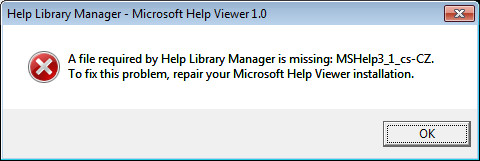

Hi , I am trying to install the demo on my home computer ( I have a licensed version on my work computer but wanted to play around with it at home as well.) I can't seem to get the components added to the toolbox when I install the demo. I do get some Microsoft help Viewer errors during installation (looks like it has to do with multi-language help files), but it's saying that it was a successful install after I click through every error. Can someone tell me why I'm not getting the tentec components added to my toolbox?

Can you tell us what version of VS you have?
Most likely, it's VS 2010 Express.
First, you may get help installation error messages if you use the Microsoft Help Viewer 1.0 supplied with this version of VS. Please, confirm that you see something like on the attached screenshot.
Second, the express editions of VS does not provide us with a way to automate the process of toolbox tab creation. In this case you can simply create a tab for iGrid.NET manually and drag the iGrid.NET DLLs onto it to create the toolbox component icons.
Igor/10Tec attached the following image(s):

Thanks for your response Igor. Yes that is the exact error I was getting. The weird thing is that I am using VS2012 but the microsoft help viewer is only v1.0. Anyway, I was able to manually add the items to the toolbox. Thank you so much.
