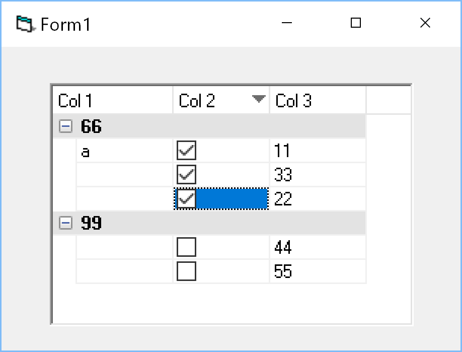

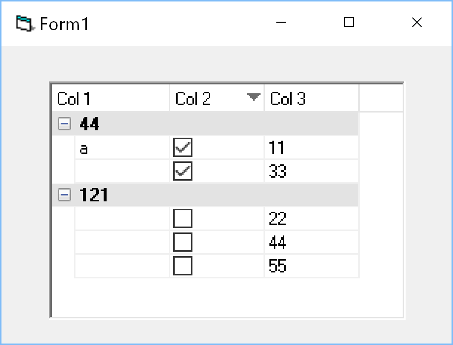

If I understand you right, you need to calculate the sum values for rows with checked and unchecked cells separately and display these total values in the group rows. I have just tried to recreate this functionality in VB6. Here is the source code of my test form's module:
Option Explicit
Private Sub Form_Load()
   With iGrid1
      .BeginUpdate
      .ColCount = 3
      .ColKey(2) = "check"
      .ColDefaultCell("check").bCheckVisible = True
      .RowCount = 5
      .CellValue(1, 1) = "a"
      .CellCheckState(1, 2) = igCheckStateChecked
      .CellCheckState(3, 2) = igCheckStateChecked
      .CellValue(1, 3) = 11
      .CellValue(2, 3) = 22
      .CellValue(3, 3) = 33
      .CellValue(4, 3) = 44
      .CellValue(5, 3) = 55
      .AggrFuncs.Clear
      .AggrFuncs.AddItem 3, igAggrFuncSum
      .GroupObject.AddItem "check", igSortDesc, igSortByCheckState
      .PrefixGroupValues = False
      .Group
      .EndUpdate
   End With
End Sub
Private Sub iGrid1_AfterAutoGroupRowCreated(ByVal lRow As Long, ByVal lItemCount As Long, ByVal vAggrFuncValues As Variant)
   iGrid1.CellValue(lRow, iGrid1.RowTextCol) = vAggrFuncValues(1)
End Sub
Private Sub iGrid1_AfterCellCheckChange(ByVal lRow As Long, ByVal lCol As Long, ByVal eOldCheckState As iGrid600_10Tec.ECellCheckState)
   iGrid1.Group
End Sub
This works. When I click a check box cell, the grid is regrouped according to the new set of checked and unchecked cells and the sum values are also recalculated correctly:

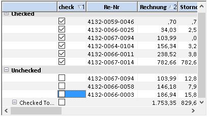

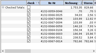

2016-10-31T08:59:04Z
sorry Igor for my bad english...
this part of the code works
it works not if I change the value of the Check box and regroup
here my Code
  10TecCode1.txt (4kb) downloaded 129 time(s).
Click to View Image153 View(s)
Click to View Image150 View(s)
there is only the initial Sum in the last row
I expect to see the Sum of the columns 5 and 6 in the checked and unchecked group
Thanks for support Igor

Emil, I recalled that this problem with the AfterAutoGroupRowCreated event in MS Access had been already discussed on our forum:
AfterAutoGroupRowCreated-event not triggering
It's a glitch of MS Access: the AfterAutoGroupRowCreated event is not fired if you do something related to grouping in another iGrid event. Nobody found a workaround yet, and the only solution is to recalculate the total values from another event handler/control. For instance, you can use a dedicated button for that.
One more hint regarding your code. You need to remove rows with level 0 from your grid before regrouping it. Otherwise you will get unneeded rows like the last one on your second screenshot.
