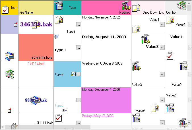

In a nutshell, you need to implement a custom DataGridView column type and incorporate a RichTextBox control with the required image and text into it. When you look at the code, you will see that it is really not an easy task. From this point of view, iGrid.NET is an ideal choice as its cells allow you to display images with texts and use various alignment options for these cell parts:
Unbound DataGridView replacement, cells with images and text
